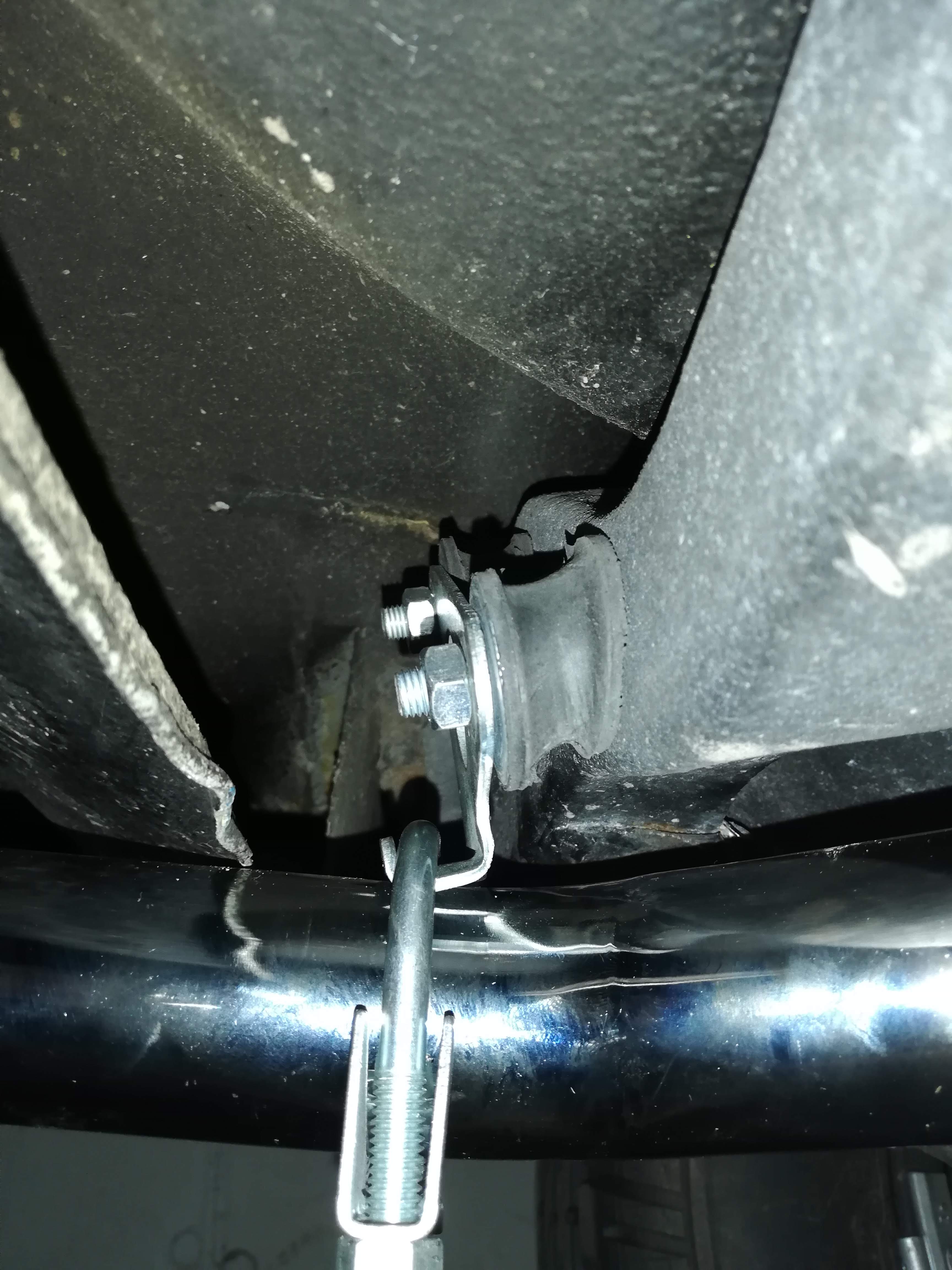

Minispares sagt, muss man eventuell bohren: http://www.minispares.com/product/Classic/Exhaust_and_manifold/Mountings/GEX7249.aspx?1103&ReturnUrl=/product/Classic/Exhaust_and_manifold/Mountings/RC40FK.aspx|Back%20to
