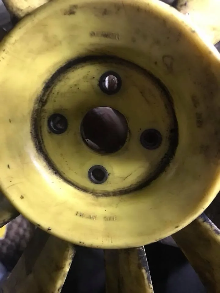

    THe efficiency is approximately 20% difference. Also please check the clearance of the blades before starting the engine as you may or may not need to add a spacer between the pulley and the fan. As it may have been removed.
    As stated it is a very common issue. Some new fans no longer have engine side on them which has lead to some of these issues.

    yes I have already checked, everything was rebuilt [attach = '40816', 'none', 'false'] [/ attach]
    just a comment, nothing to do with your problem but it does look like the cooling fan is on the wrong way around. The smooth center should face the engine not the radiator. On the original ones it even had “engine side” on the face. There is a reduction of about 20% of cooling ability when the fan is incorrectly fitted. If it is fitted correctly sorry but it just does not look right.
