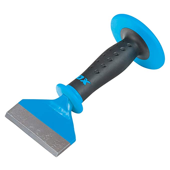

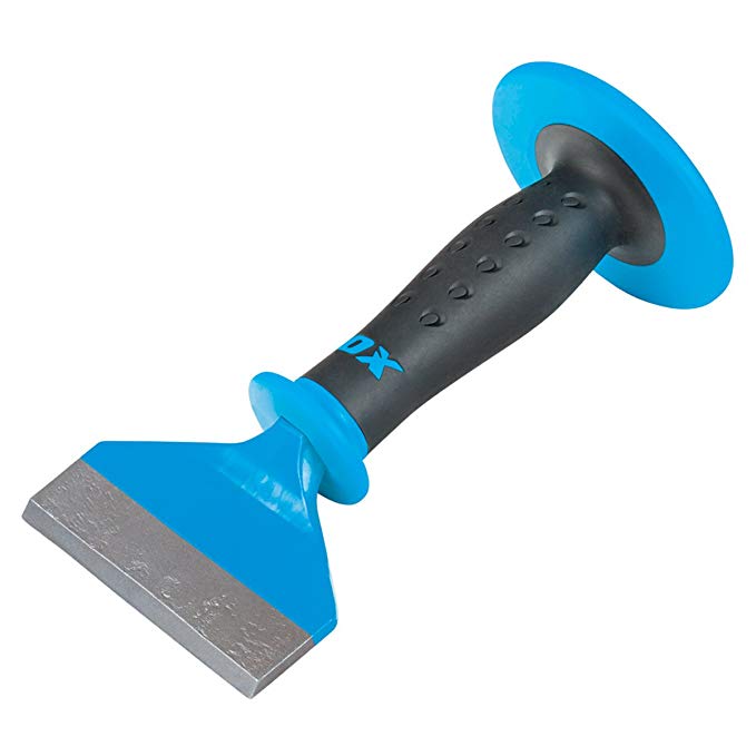

to seperate the rubber from the aluminum trumpet a good soaking with some release agent (sorry not sure of a good brand here, still looking myself) and then use a Masonry chisel to separate the parts like
note that the rubber has a steel insert that can remain on the aluminium trumpet and will need removing as well. then again soak with a release agent and then with a metal rod tap the Knuckle out.
