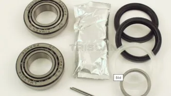

  • A.B.S. 200586
    BORG & BECK BWK027
    COMLINE CBK100
    CORTECO 19017670
    DELPHI BK103
    FIRST LINE FBK027
    FREMAX FWB-0218
    GSP GK0749
    METZGER AUTOTEILE WM 159C
    MOOG RO-WB-11633
    OPTIMAL 881592
    QUINTON HAZELL MWB159 + QWB 159C
    SKF VKBA 749
    SNR R161.09
    SPIDAN 26832
    Schaeffler FAG 713 6201 30
    TRISCAN 853017107
